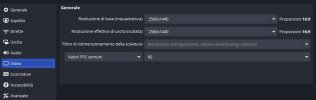

Also some of my OBS setting rn

The outpur resolution in video can be also an issue?
