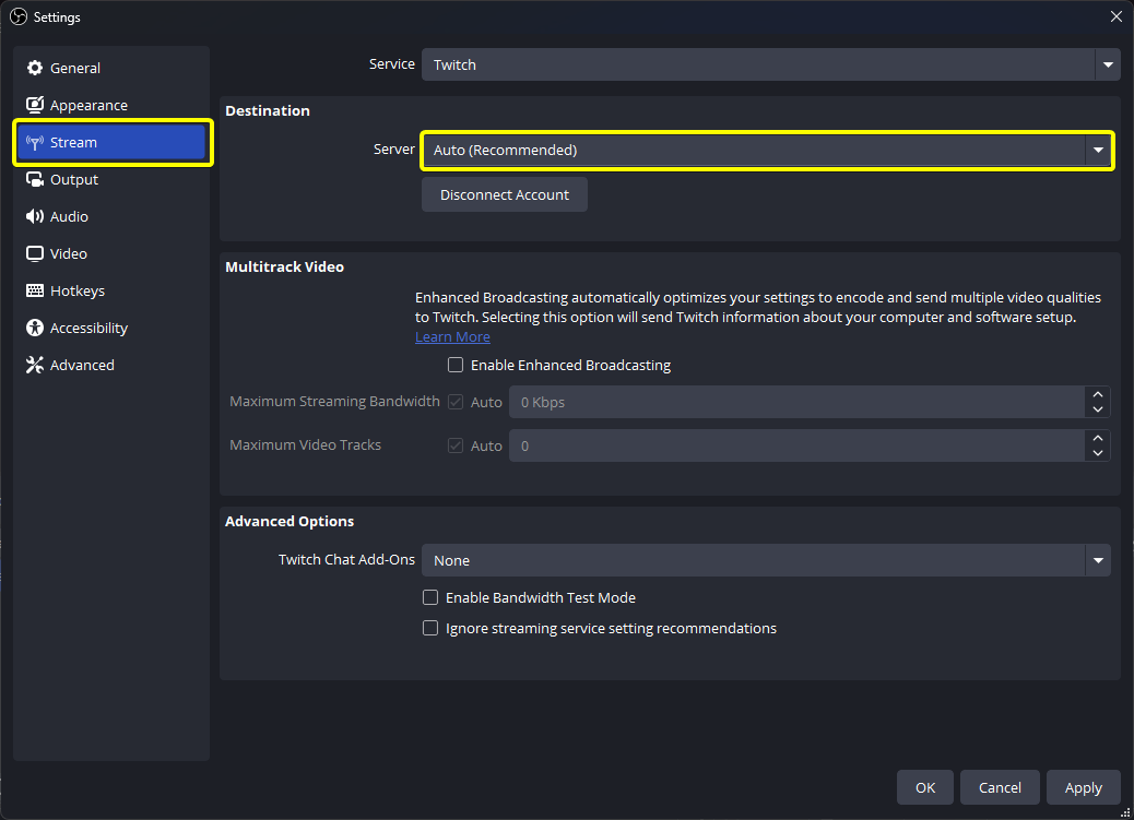

  1. Stream to a Different Server
  • Go to Settings → Stream and try streaming to a different Server
    • Note: if you are streaming to Twitch and are using Windows you can use TwitchTest to find the server with the best Quality score. You may want to also test with Enhanced Broadcasting disabled or with a Maximum Streaming Bandwidth set below the bandwidth you are seeing in your TwitchTest results

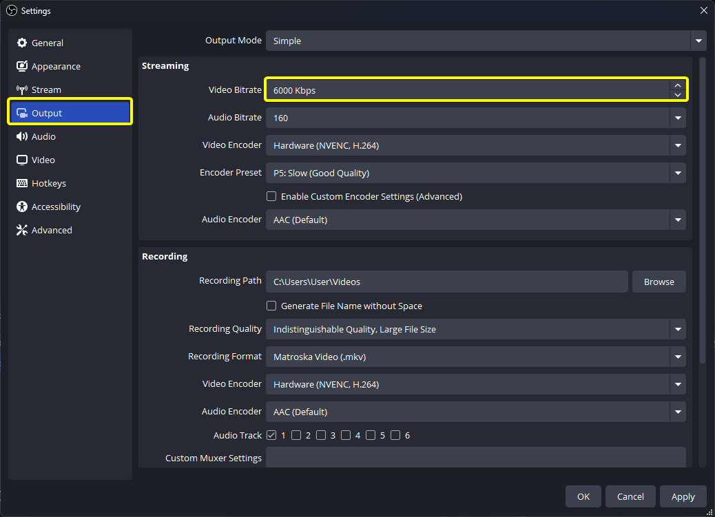

  1. Lower Your Video Bitrate
  • Go to Settings → Output and lower your Video Bitrate. The bitrate will depend on your stable upload speed and the bitrate limitations set by the streaming service. A good starting point is to set your bitrate to 75% of your total upload speed

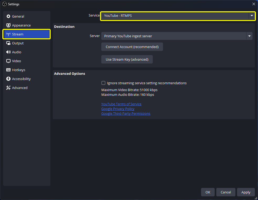

  1. Stream to a Different Service
  • Go to Settings → Stream and try streaming to a different Service. For example, if you are streaming to Twitch, test your connection by streaming to YouTube
    • Note: while this won’t solve connection issues with a specific service, it helps identify if the problem is service-related

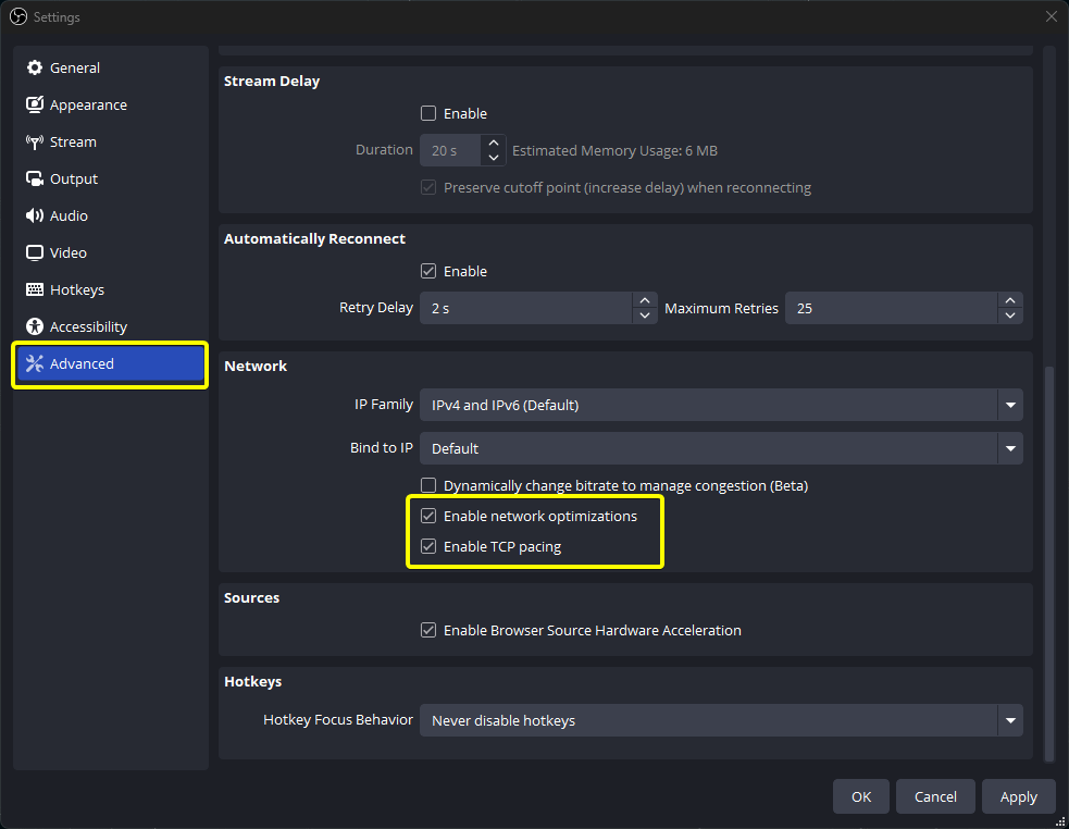

  1. Enable Network Optimizations and TCP pacing
  • Go to Settings → Advanced → Network and tick the Enable network optimizations box, then the Enable TCP pacing box. Some users have reported that this helps with their dropped frames or disconnection issues. It also adds further details to the log for troubleshooting purposes
    • Note: these settings are only available on Windows

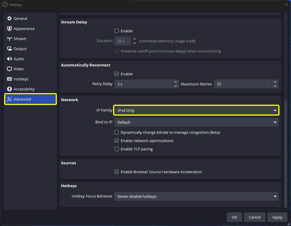

  1. Set IP Family to IPv4 Only
  • Go to Settings → Advanced → Network and set IP Family to IPv4 Only
    • Note: if this change makes no difference with your connection issues it is recommended to leave it on the default setting of IPv4 and IPv6

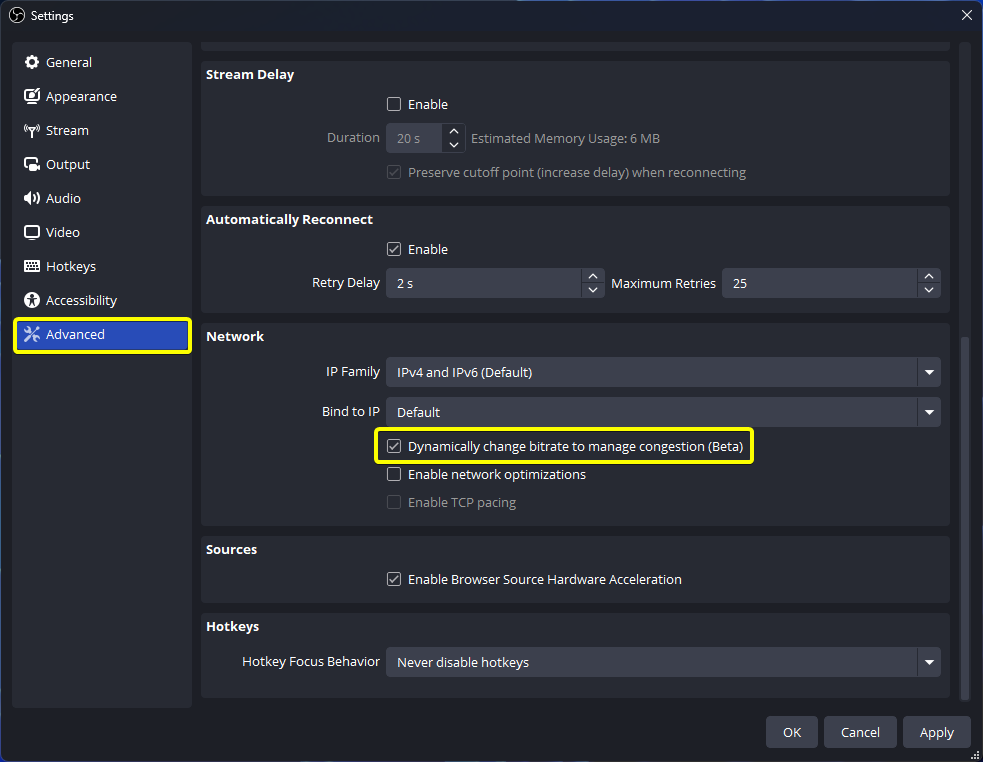

  1. Enable Dynamic Bitrate Adjustment
  • Go to Settings → Advanced → Network and tick the Dynamically change bitrate to manage congestion (Beta) box. This will lower the bitrate when your connection cannot keep up, rather than dropping frames
    • Note: this doesn't solve the root cause of dropped frames and should only be used if you cannot resolve the underlying connection issue. Lower bitrate will also result in reduced video quality
