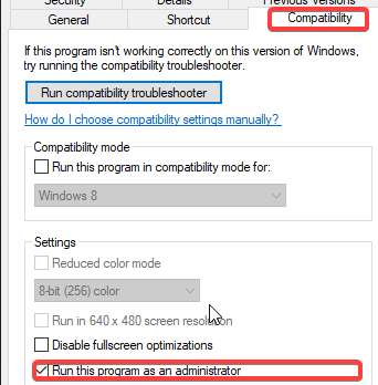

OBS Studio can ask Windows to reserve some GPU capacity for its use. In many cases, GPU overload issues can be resolved simply by running OBS Studio as administrator; try that before continuing with this guide.
  • To run OBS Studio as administrator, close OBS Studio.
    • Right click the OBS Studio shortcut
    • Select Run as administrator
