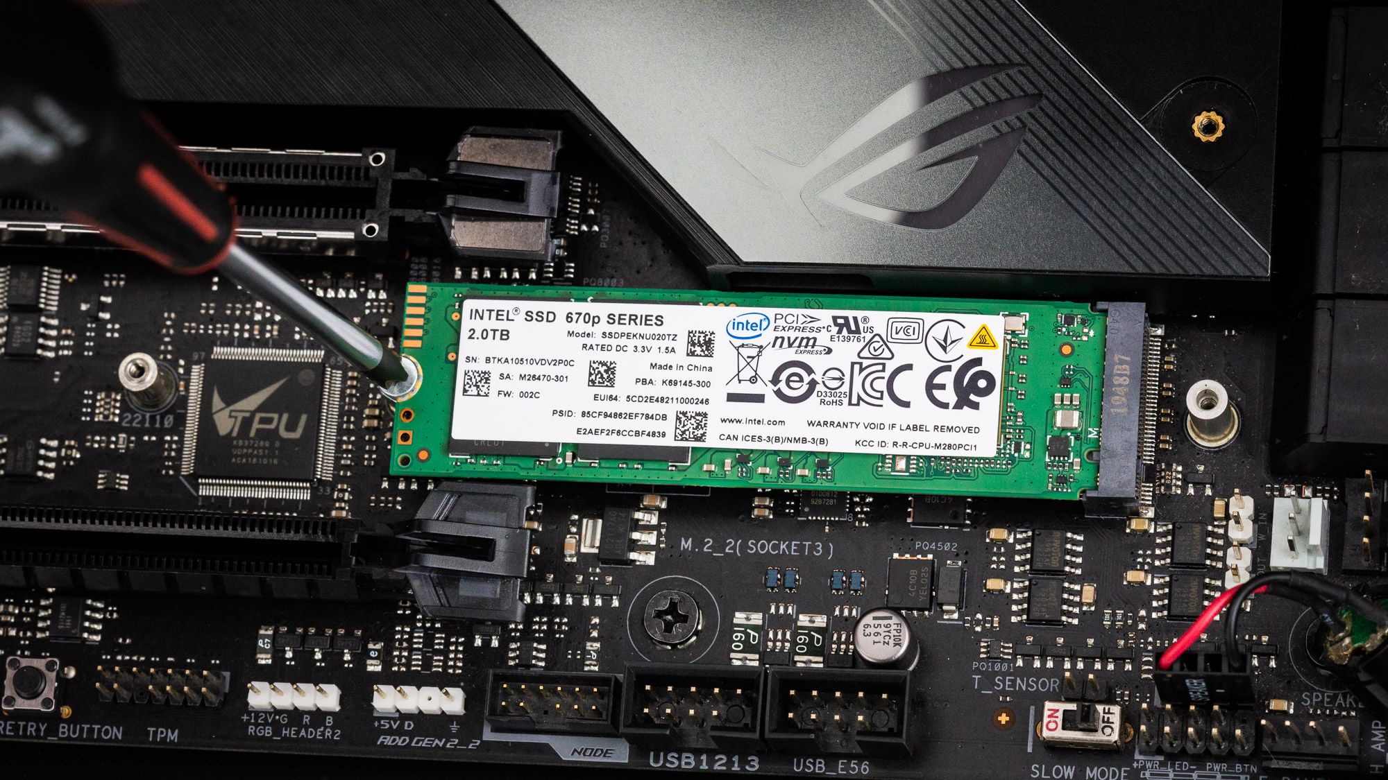

Try the Intel, I found a picture of it, looks like there's DRAM on it. The Timetec has no DRAM.
DRAM Cache No
Aaron Lin
DRAM Cache No
Recording directory back to the OS? My OS uses the Intel one.
rockbottom
Yeah, I know but the Timetec is a non-starter, it's not suitable for recording unless you want to record just a few minutes at a time.
