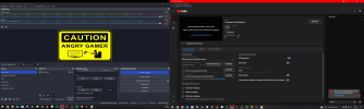

The essence of the problem: I have 2 monitors. On the main one I have a game, on the other one - OBS with chats and stuff, all through dock panels. The game (this is how all games behave) runs fine, but when I press alt-tab and do something on the main monitor (where the game is) - everything starts to slow down and freeze, I can't press any button in the system tray or taskbar. When I run the stream through a single, main stream (only on youtube, without plugin) - everything goes fine, but with plugin - I can't press alt-tab to check something, I can't even press win button - everything starts to freeze terribly. It freezes only and exclusively when I do something on the main monitor.
Today, at some point, I needed to switch to Steam on the main monitor. Everything slowed down terribly, Steam, as well as all programs and the whole system in this situation, strongly freezes, and after some time, when I was able to return to the game - everything went well, but when I reviewed the VOD of the stream - the part that was after switching to Steam and back - terribly freezes, it felt in the video was 15 frames....
In general - why when you alt-tab, or click on wine, everything slows down so much on the main monitor? Only when using Multiple RTMP outputs plugin.
I'm capturing the game through Game Capture, all the OBS log analysis shows no problems.
4080 super, 7800x3d 32 ddr5, i really doubt that this is hardware issue.
