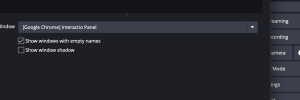

Any luck with this? I'm having the same issue. I can solve it by doing a display capture on my monitor, but would prefer to use the window capture
I was able to show the subtitle or CC from zoom using the "Display Capture" instead of the "window Capture". You will need to do some organizing to have the ZOOM window on top and in the right size but works
Enable this and then it finds zoom caption window
