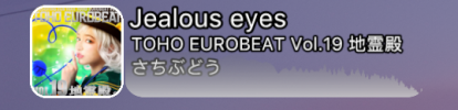

Hey guys,
First of all thanks mate for keeping updating the plugin and its wonderful. I have an annoying problem here that the plugin not fetching the name of the artist and song and it stuck with the one played in the beginning. The cover working great but not the song. Its about Spotify :)
