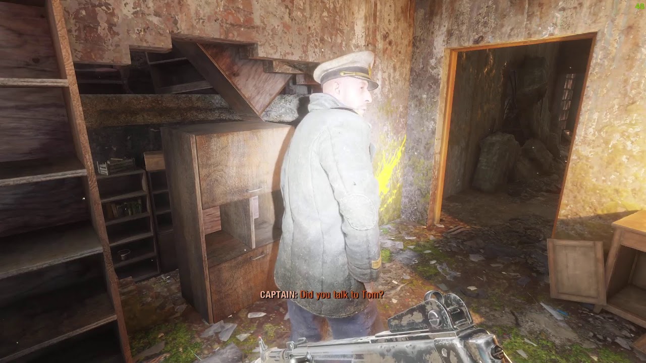

Me too! MW 2019 works terrible with OBS. My footage looks exactly like in the Metro example videos. I tried Overwatch just now....runs perfectly fine with Game Capture.
As described here many times before, I can also see the lag in the preview window, before I even start streaming. The screen capture method works way better. It's still not flawlessly fluid. As many others mentioned as well.
