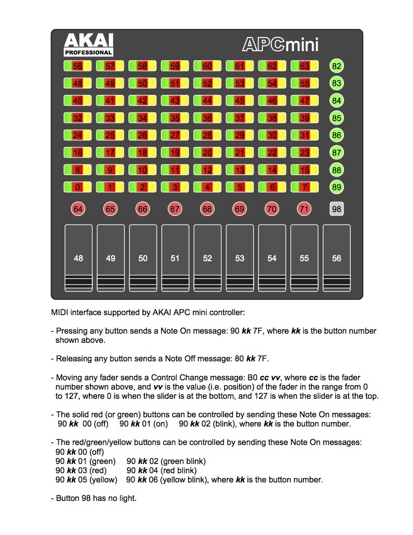

If I may add Volume for faders would be awesome too! And Midi feedback to the devices would be super useful, if you use something like an APC Mini or Launchpad etc. you could use that to switch on (off)) the LEDs on the pads...
I'll receive a APC, so I'll be able to debug/implement it. It was quite hard to guess how it works without being able to test it :p
Great news about MIDI Feedback, working on it since I got a APC mini.
My work will be based on this : http://www.qlcplus.org/forum/downlo...id=ab19f63c0e9fcfe34bc7a25d2ff98036&mode=view
In order to work with Launchpad (or other MIDI devices), I'll need something similar (and no, I wont buy all of them :D )
