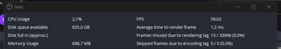

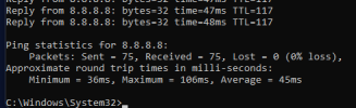

Ive been streaming for years and and just last week my streams started dropping network frames MASSIVELY. I havent been able to get one stable stream out. Ive never had this issue before, ive made sure ive updated all drivers, checked my settings in OBS, reset my modem, changed ethernet cords. I even reset my entire pc. Its still doing it. I will provide my logs, someone please help. :( all of these logs are just from tonight. I will also provide my pc specs. Im also having some redering lag. No packet loss on test.
