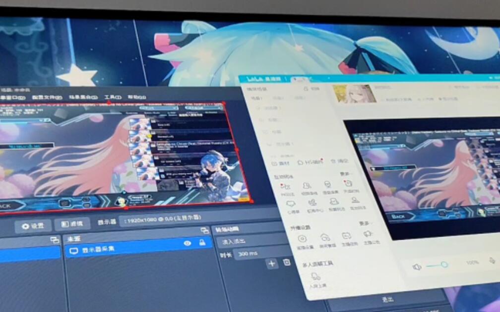

So I uninstalled obs and reinstalled it and reset all settings of obs
But the problem is still not solved. Although it prompts that hardware acceleration is turned on by default in win11, I don't think it is a problem with this thing. This function was always turned on before the problem occurred.
In addition, because I reset all obs settings, the current obs only added monitor capture, which still did not solve the problem.
I solved all the problems according to the analysis tool, but when the game is opened in full screen, the OBS output screen is still still and frozen.

It’s still the same as the video I took before (the additional monitor is plugged in for intuitive performance, because you only have one monitor and you can’t see what the obs status is when playing in full screen)
After that, I tried to change the direct connection function of the laptop to the mixed output mode, and the obs problem magically disappeared. However, the problem still existed when I switched back to the direct connection function.
I have tried updating the graphics card driver, but the core graphics driver still cannot solve the problem.
One problem with using game capture directly is that after selecting the full-screen window, the position of the game displayed on obs cannot be adjusted. This is the main reason why I insist on using monitor capture.
所以我卸载了obs并重新安装它并重置了obs的所有设置
但是依旧没有解决这个问题尽管他提示win11默认开启的硬件加速但是我不认为是这个东西的问题 没出问题之前这个功能一直都是开着的
另外因为我重置了所有的obs设置现在的obs只添加了显示器捕获 依旧没能解决问题
我按照分析工具给出的问题全部解决了一遍 但是游戏打开全屏 obs输出的画面依旧是静止 冻结的状态

仍然和我之前拍的视频一样 (额外插显示器是为了直观表现 因为你只有一个显示器全屏游戏时看不到obs是什么状态)
之后我尝试把笔记本的独显直连功能改为混合输出模式 obs的这个问题就神奇的消失了 但是换回独显直连这个问题依旧存在。
我尝试过更新显卡驱动,核显驱动 还是无法解决。
直接使用游戏捕获有一个问题那就是选择全屏窗口后 无法调整游戏在obs显示的位置 这是我坚持使用显示器捕获的主要原因
