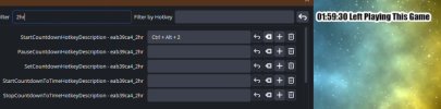

Hey, unsure if the plugin is or is not capable of this need, but I figured I'd ask.
I've got it installed, 3 countdowns, 1 per amount of hours (1, 2 and 3)
I'm using touch portal to control elements on my stream, so I have a button to make 1 hours countdown appear, 2 and/or 3 depending on my needs.
I set the 1, 2 and 3 hours in the 'Countdown' settings and I see a few choices on hotkeys in the OBS Studio settings, but I either don't see an obvious one, or it's not possible.
Basically I'd like Touch Portal to turn on the source of the countdown, which it is, as it's toggles the 'Text (GDI+)' that the countdown is using, but then when I assign a key combo to one of the key hotkeys available on the countdown, none of them reset the counter to it's set value in the settings, i.e. the 1, 2 or 3 hours?
Is there a way to reset the time of the countdown from the hotkey combos, to reset the timer/countdown back to it's default I've set on it's relevant settings?
So, say I press a button on Touch Portal, it would send a ALT+CTRL+1 over to OBS Studio and then OBS Studio tells your plugin to reset it's time on timer 1, for example? [obv keys/combos, etc are just examples]
Ideally, I'm wanting an little countdown to tell people how long on the particular game I'm playing is left
Thanks for your time.
Regards
PJ.
