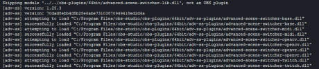

Hi, Advanced scene switcher isn't working in portable mode after the OBS 31 update. It is actually working fine in non-portable version of OBS, which is updated to 31 as well, but giving issue in portable version.
I've attached screenshots of the log from non-portable version where its working fine as well as the portable version where its not loading up at all.

Hi,
I just gave it a try with a fresh OBS 31 portable install and it seems to work.
What exactly is not working on your end?
The "advanced-scene-switcher-lib.dll" not begin loaded is expected as it is not an obs-plugin just as the error states and instead a lib used by the advanced scene switcher itself.
Unfortunately, I think your issue is more likely related to you using version 1.25 of the advanced scene switcher.
This version being compatible with OBS 31 in non-portable mode is just a happy accident.
OBS 31 support was only added with advanced scene switcher 1.28.

UPDATE: I just updated plugin to 1.28.1 and that isn't working on OBS portable 31.0.0 as well.
