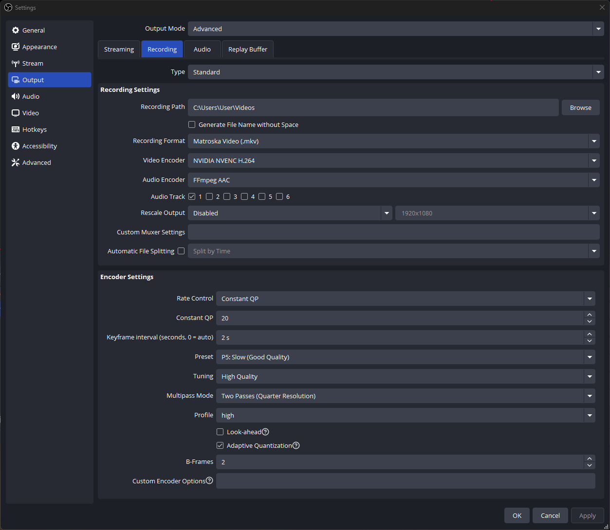

NVENC
  • Rate Control: Constant QP
  • Constant QP: 16-23 (Lower CQ level will result in higher quality and larger file sizes)
  • Keyframe Interval: 2
  • Preset: P5
  • Tuning: High Quality
  • Multipass Mode: Two Passes (Quarter Resolution)
  • Profile: High
  • Look-ahead: Off
  • Adaptive Quantization: On
  • B-frames: 2

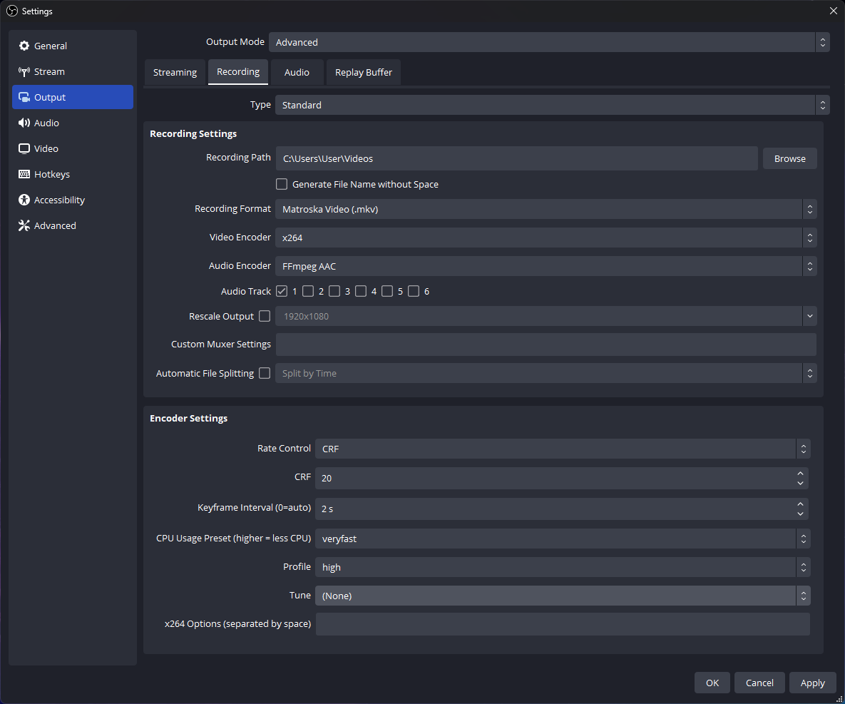

x264
  • Rate Control: CRF
  • CRF: 16-23 (Lower CRF will result in higher quality and larger file sizes)
  • CPU Usage Preset: veryfast
  • Profile: High
  • Tune: (None)

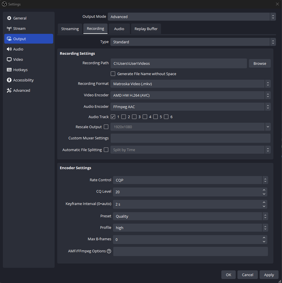

AMD
  • Rate Control: CQP
  • CQ Level: 16-23 (Lower CQ level will result in higher quality and larger file sizes)
  • Preset: Quality
  • Profile: High
  • Max B-frames: 0

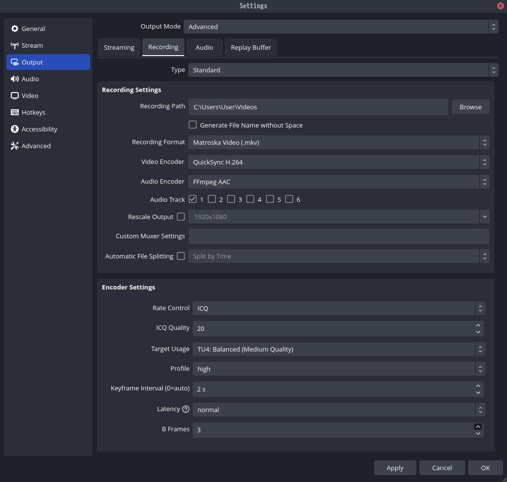

Quicksync
  • Rate Control: ICQ
  • ICQ Quality: 16-23 (Lower ICQ Quality will result in higher quality and larger file sizes)
  • Target Usage: TU4
  • Profile: High
  • Latency: normal
  • B-Frames: 3
