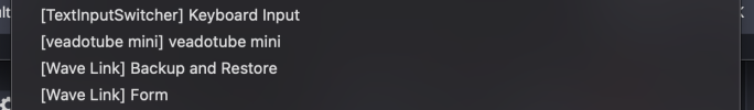

I use a hub to connect all my devices (capture card, microphone, streamdeck), and I stream from a MacBook - so when I disconnect the hub and reconnect it, OBS never remembers my capture card, and I always have to refresh it...
Is there a way to make sure I can disconnect the hub, reconnect it and not have to do this every time?!

I'll explain it maybe better this time. I have to reselect my device from the properties menu each time I connect the USB, and the same issue goes for using Veadotube, where I need to select the window I want it to capture. I started using Advanced Scene Switcher, and it has the option to select these things when a certain state is present, you can ask it to get current settings, which is a random string of numbers, but again after you unplug the UBS and plug it back in, that string also seems to change, so I can't even use this to automate it...

the photos provided show the greyed out version of the capture card previously selected, I have to reset to default for it to refresh the list, to allow me to select it again - and within the list of Veaodtube, it auto selects something from the list, and doesn't ever remember I want veadotude selected.
