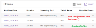

I'm trying to set up Twitch's Enhanced broadcasting mode in OBS. I've tried testing the setup by turning on "Enable Bandwidth Test Mode" and via the Twitch Inspector; it detects and runs fine without any issue.
However, when I turn off the test mode, both the Twitch Inspector and my Twitch Dashboard still detect as Offline. The weird thing is that in the Inspector, it still detects my "live" stream, but reports no data...
Ive attached all I could think of to show my findings, but feel free to request anything else from me and I'll get it to you ASAP.
