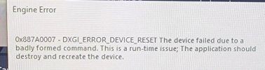

I really have no idea why it's crashing. I tried display capture today and was just gonna stream with black bars and it crashed immediately. There is no crash log that shows up. Does this mean apex is crashing when I stream and ob just crashes subsequently because apex crashed? regardless, this issue only occurs while streaming. I will post logs since that's the only info I have and the errors I am getting when it does crash. One of the errors is from apex when it crashes and the other is from obs when it crashes. keep in mind both are crashing not just apex and this only happens when I stream.

Oh, I had this before. Under Settings > Output (Advanced), change the Multipass mode to "Two Passes Full Resolution", seems half res breaks. This fixed it for me, haven't had that specific error in a bit

I will try this. My last option was uninstallling and reinstalling apex which I did when I posted this but I haven't had time to test it yet. I'll also change it to two passes full resolution next time I get on and stream and see if that fixes it. Thank you so much for the help. I'll reply if the issue persists after this and if it doesn't after a few days I'll also come back and let you know. Thanks again!
