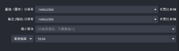

@dev47 Hello developer, how can I use the 9:16 mode? I set it up like in the picture, but it still shows a 16:9 ratio in the instant messaging software.Hope to get your help.My English is not good enough, so I used a translation software.
