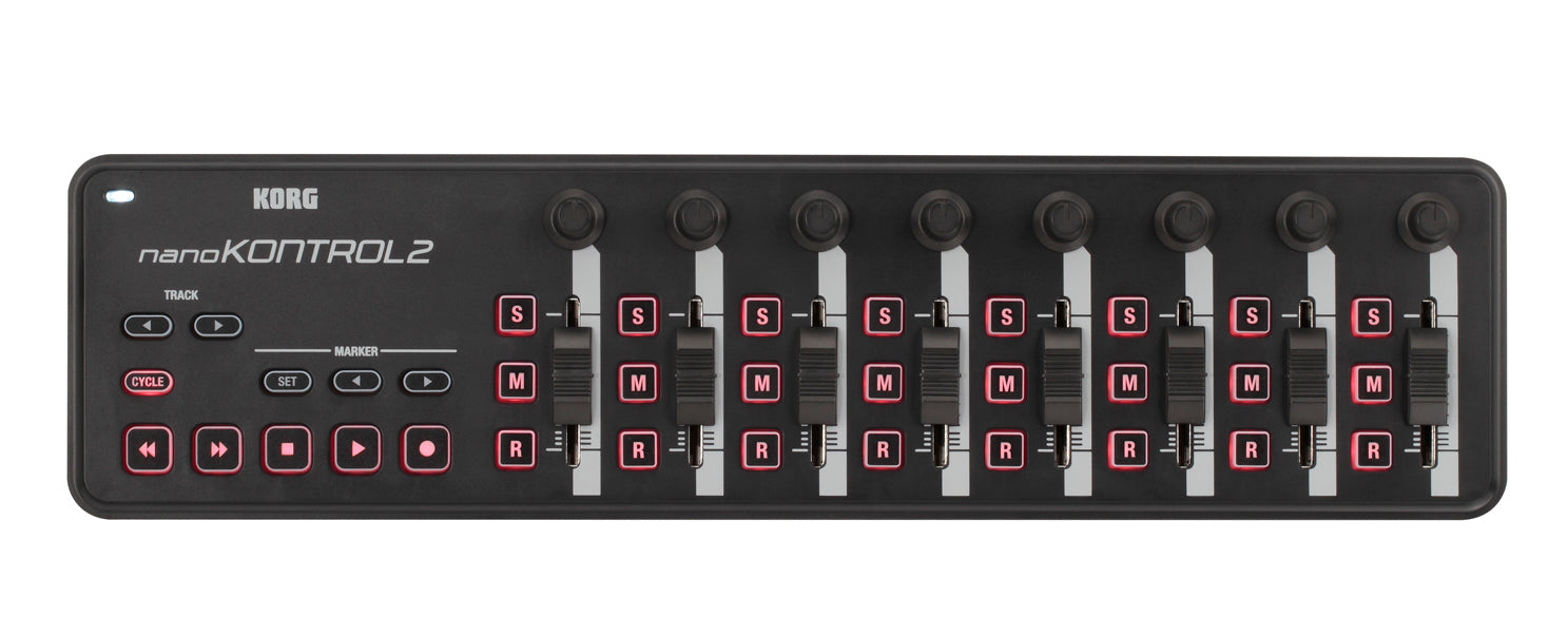

I thought it should have been simple: just add a MIDI condition and let it auto-detect. But it doesn't seem to see the Korg nanoKontrol 2 that I just happened to have lying around:
The "Reconnect all" button doesn't fix it, nor does restarting OBS.
QLC+ does see and use it, on the same machine, so I know it works.
