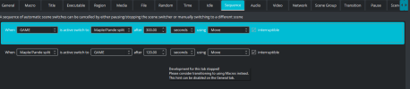

Ok, so I simply want to loop between two scenes but using macros this simply isn't working, a friend and I spent 3 hours banging our heads together and finally found a solution but it seems the solution is going away?( attached) how can I get this to work with macros? we tried Sequence macros but it stops and doesn't continue to loop. We're either both really dumb (likely) or macros aren't fully working yet for this kind of thing?
It says development of this tab has stopped and switch to macro's but I can't get it to work for the life of me.
Using the tutorial that has everything in one macro with Waits in between, yes, that's true. Macros don't loop, so you have to explicitly re-trigger it every time if you go that route.

So the solution is not loop but make a shit ton of macros? that seems stupid since the sequence thing is in the list of macro's and it says that it will restart from the beginning once the end is reached so one would assume it would start macro 1 again go to macro2 and repeat? but it doesn't, seems broken to me.
