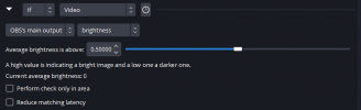

Quick question about Video -> Brightness. Am I able to make the macro trigger if the brightness goes under a set level? I think by default it only triggers of it goes over the value.
Thx <3
