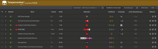

Step 2: Create a New Tampermonkey Script​
  1. Open Tampermonkey:
    • After installing Tampermonkey, click on its icon in the Firefox toolbar.
    • Select Create a new script.
      click on the + and a new Script will appaer
  2. Add the JavaScript Code:
    • Delete all the Default Information first -
    • Below insert the full Tampermonkey script. It listens for OBS WebSocket events
      and pauses or resumes video elements (or other actions) accordingly
      and then Copy & Paste the Script
    • Step 3: Save and Activate the Script​
      1. Save the Script:
        • Once you've pasted the script, click on File > Save in the Tampermonkey editor.
      2. Adjust the @match Directive:
Step 4: Test the Script​
  1. OBS Setup:
    • Ensure that the OBS WebSocket plugin is installed and running. The default WebSocket address is ws://localhost:4444. Adjust the OBS_WEBSOCKET_URL if needed.
    • If you have set a WebSocket password in OBS, include it in the OBS_WEBSOCKET_PASSWORD variable.
  2. Open the Target Website:
    • Go to the website where you want the script to control the stream (e.g., a video platform).
  3. OBS Actions:
    • Start recording/streaming in OBS. When you pause/resume recording, the script will detect it and trigger the appropriate action in the browser (such as pausing/resuming a video).
