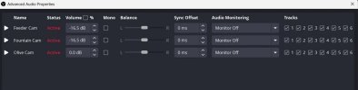

Each encode can contain up to 6 audio tracks. The bit-rate for each track is set on that tab. Tracks are selected on the Streaming & Recording Tabs. Open Advanced Audio Properties to customize the tracks.
I dont see where I can control audio bit rate for the streams.

So sorry I just don't see any setting that controls the total output of the audio for the three cameras maybe I'm blind maybe I need to be kicked in the face. hey I'm a quick study, but I am 60 year olds old now and I've forgotten more than most people will ever know so?
Yes I just looked at that and I unchecked all check boxes and figured out everything is running off of channel 1.
I unchecked all other channels.
yeah I don't do any recording at all from obs just use it to stream what you see very limited and I keep the resources very low I don't need to record or do anything I just need to stream this one thing. I do all my video editing and davinci resolve I do all my sound editing and studio 1 pro I just use obs to stream this one thing I don't get any more technical with it than that all is good.
It's OK it looks like everything I have is just on channel 1 and checked all the other channels not sure that makes any difference.
So knowing what I know now all three cameras come in there at 128 kbs, on channel 1, so I am going to up that to 320, Wow sound is much better, al lot cleaner if you can believe that.
