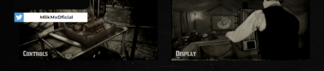

I see a difference in the whites that are reproduced while gaming and streaming in HDR. As you can see in the image, the white from the texts from the menu's look washed out compared to the white of the browser source.
This is currently on Windows 11. If I capture the game in window capture (bitbit) the tonemapping HDR-SDR is perfect, but in display capture the output is really dim.
Please provide an OBS log file of when this issue occurred/occurs. Without that, it's difficult to make any guesses.
Hopefully you can see the difference in the tone of the white of the Read Dead text title. The second picture was taken when the game was in HDR, but in borderless mode (the screenshot is from OBS preview).
