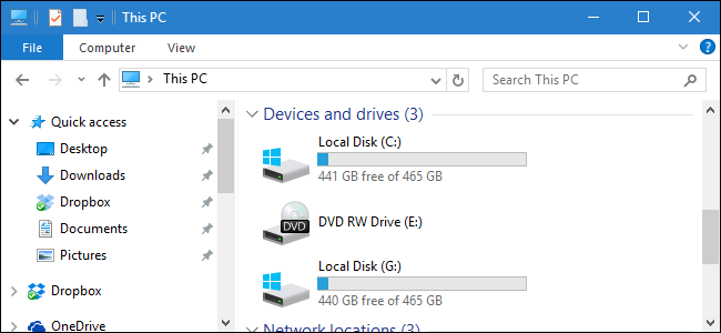

Correct view for Task Manger, what's up with your HD's are you using RAID?
OK don t want to be insistant but ShadowPlay can record no issue on the HDD 7200 RPM Seagate Barracuda.
I m not using RAID Architecture, these are Physical : 1x Seagate FireCuda 510 SSD NVMe 1 TB + 3x 8 TB Seagate Barracuda 7200 RPM HDD + 1x 4 TB M3 USB External Seagate Maxtor HDD.
Use ShadowPlay if you don't want to take the time to test & get it to run correctly.
aaaaa OK Because of the letter : Because on these 5 Drives I Have Partitions too !
Don t worry no issues about that !
All aware of it and it s normal, I have at least 2 Partitions on Each drive.
