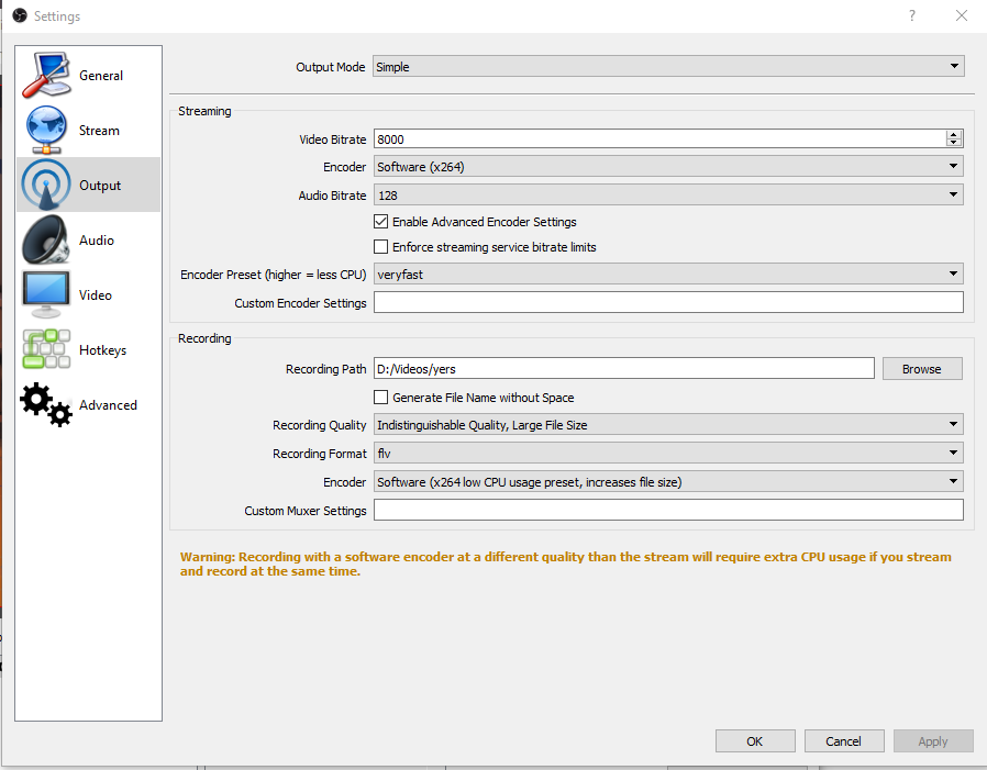

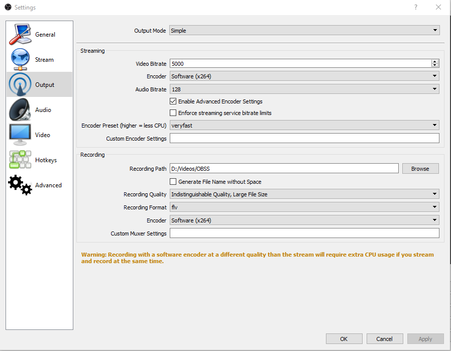

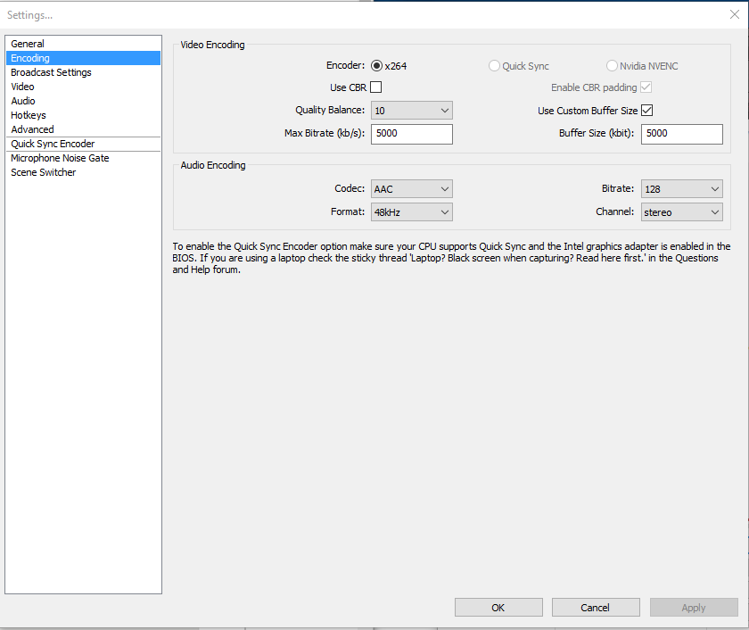

Hey guys,
I'm trying to record some overwatch gameplay, My hardware should be able to record 1080p @ 60fps.
I'm currently rocking a R9 280x vapor-x 3GB edition, i5 4670k @ 4.3Ghz and a z87-G45 MSI motherboard, it's a 620w PSU (which I'm not sure is needed but like covering all bases)
I'm trying to record gameplay of overwatch at 1080p60fps using OBS Studio it's giving me a warning "High encode" at anything more than 4000kbps (bitrate).
I tried using a different software but it's bad quality and I'd like to stick with OBS because of the streaming options available.

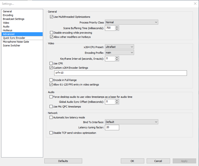

These are my settings below, I'm just wondering if that hardware is sufficient for 1080p recording or if it's time for an upgrade or could I tweak something to make it a bit more doable.
OBS Settings (This is for standard, I'll grab my studio ones when I get home.)
https://i.gyazo.com/c94265808105c7fcb28a7435edbfc275.png
https://i.gyazo.com/1349ceefcb53bd320e25bb1482af5569.png
https://i.gyazo.com/e7d4d66999755251a1821ffdecc1b03f.png
Thanks for checking out the thread it's very much appreciated, I'm still learning all these things so it might sound all over the place!

Judging from those screenshots I'd say you are not using OBS Studio, I've asked the Mods to move you to the OBS Classic forum. You'll need to post a log though, details on how to do that for OBS Classic are here:
https://obsproject.com/forum/threads/problem-make-sure-to-post-a-log-and-or-crash-dump-howto.97/

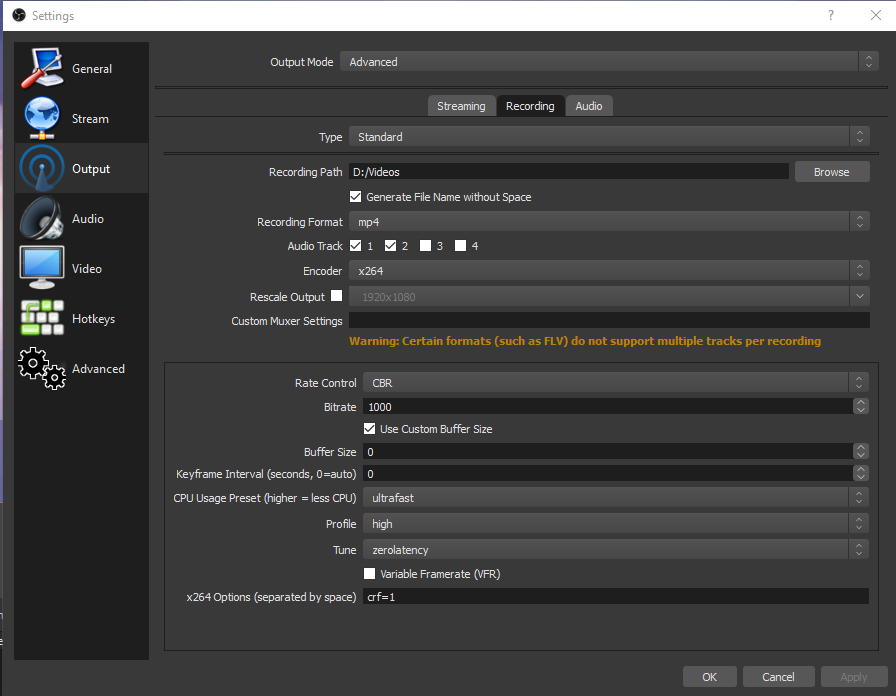

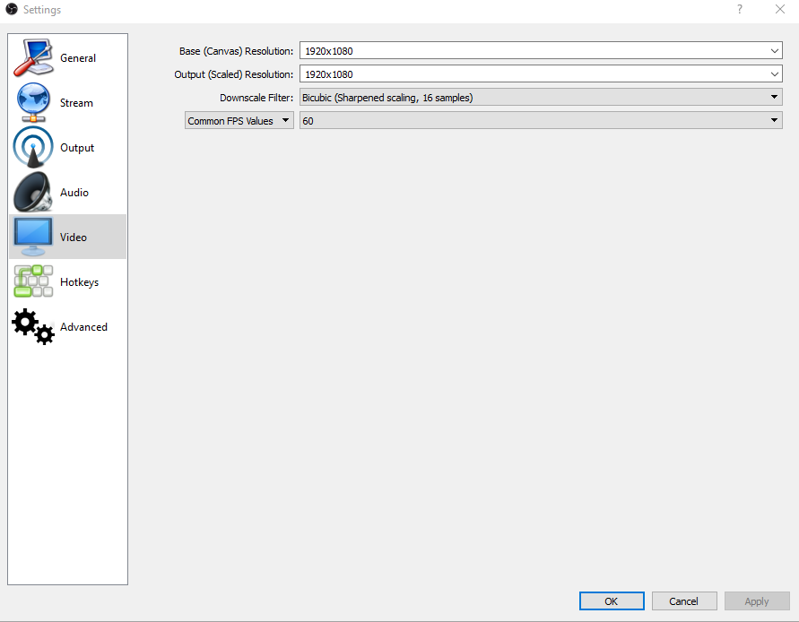

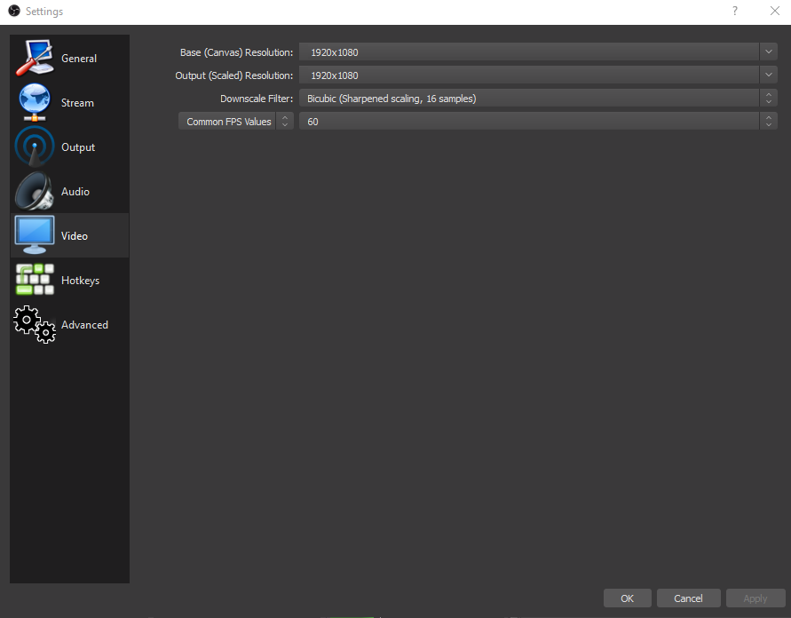

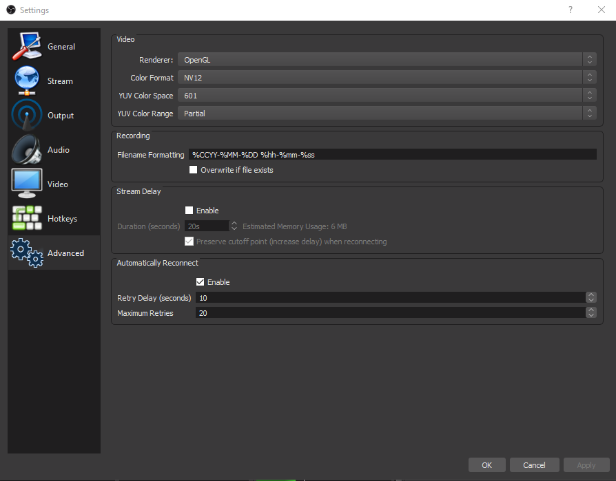

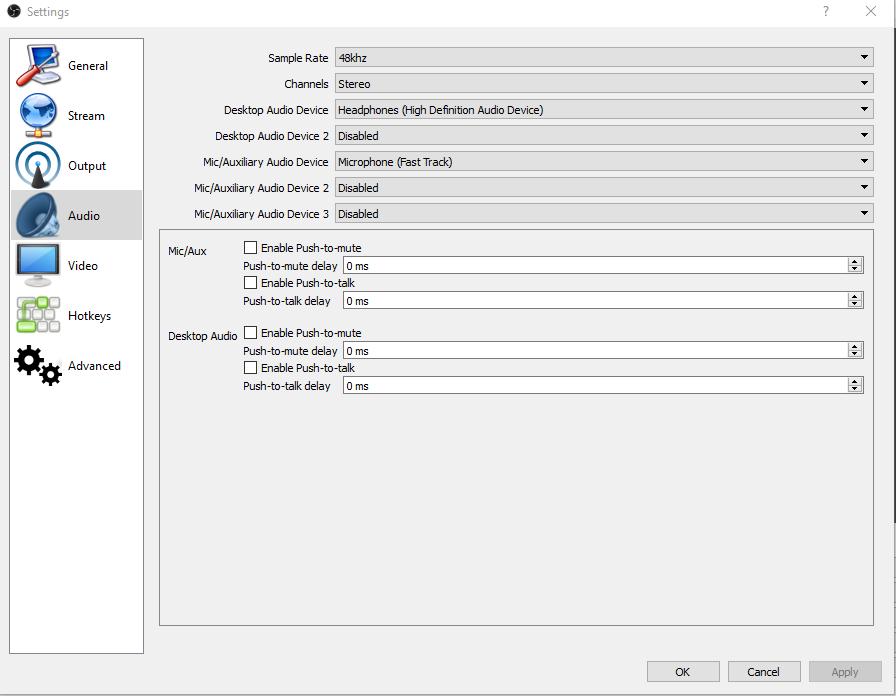

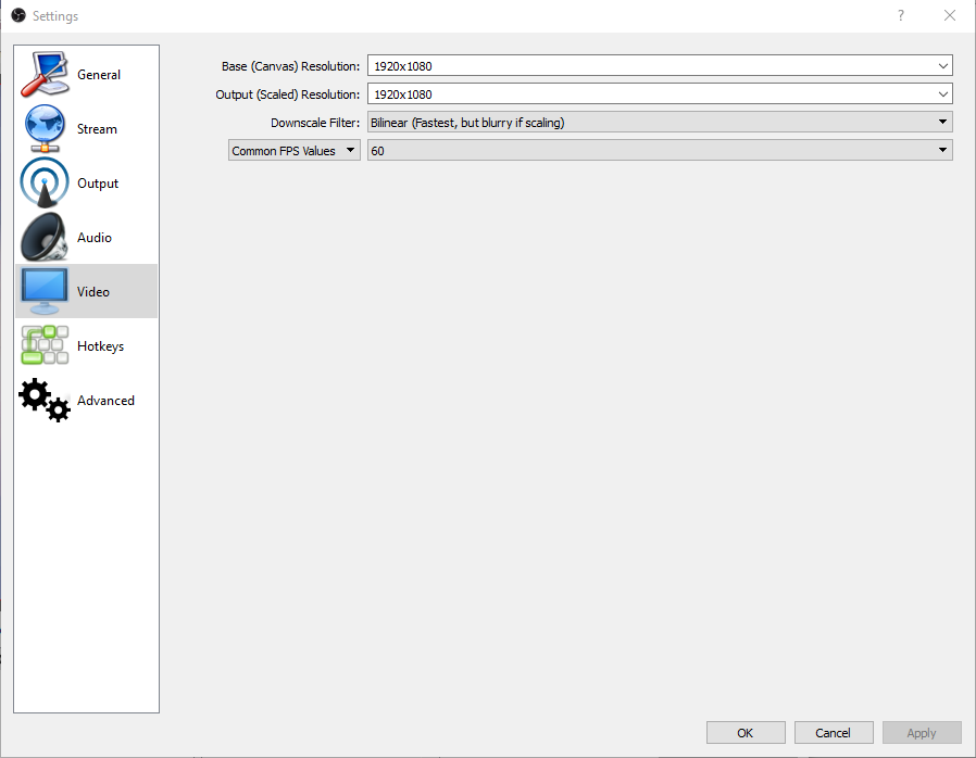

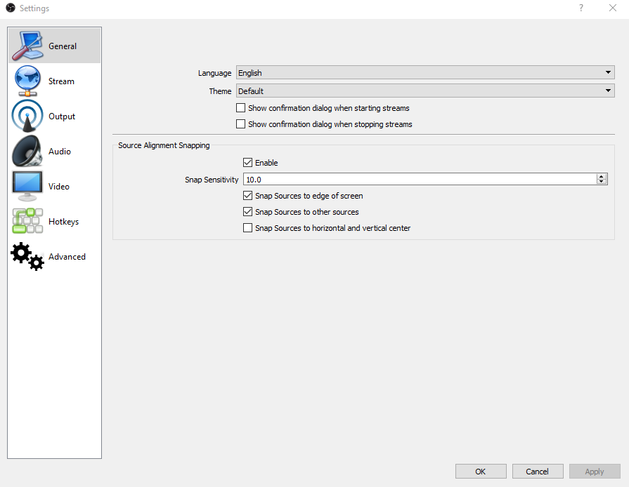

Hi, here are the settings for studio.
https://i.gyazo.com/31d416251d0b42bb45479e6e1a618920.png
https://i.gyazo.com/f93ab3c18919a78cef689f0c9f4346e4.png
https://i.gyazo.com/714e4a5be5f47d4ad568da54fd7e0749.png
https://i.gyazo.com/daa3872f74e71f0a0ce862489559d7db.png
https://i.gyazo.com/a2ffa471b0690339a2723eca46a7fd39.png
I'd like to get it working on either because they're both having the same issue:(

For Studio. If you are using same Canvas size and Output resolution, then you may setup Video>Downscale Filter: Bilinear.
Look at this thread: OBS has horrible framerate with Overwatch.
And you may try 30 fps setting instead of 60, or you can lower resolution. Also, Encoder: Software x264 (low CPU usage preset...) acceptable, or try HW encoder if any.
Ned
I'd like to keep it at 1080p, I've set that filter, I'll try 30 fps.
My issue is kind of like that vidoe but it completley freezes for a few seconds.
Ned
These are the updated settings and they work nice, What Can i do to make it less stuttery and not compromise video quality since it still gets a bit of lag during recording, It;s not even hitting 100% cpu usage most of the time.

The problem in this case is more likely the GPU power. Overwatch might fully utilize your R9 280 already, hence OBS gets no room to render the frame and the video lags, although there is enough CPU power to render everything.
Activating vsync might help if it free's up some room on the GPU for OBS.

So if I was to use AMD's game profile and lock it to 60 fps (Running on 150 usually) would it still help ?

It should help, definitely give it a try. Maybe lowering the graphics settings of Overwatch (only some less visible settings) could help too.

So I played around with it a bit more, OpenGL Renderer works really well, Are there any downsides to using this over DX11, I'm thinking because overwatch is using dx11 it's slowing everything down a bit more.
I've also been playing around with the AMD Encoder, Do you have any suggestions on settings because my 9000bitrate recording doesn't look as good as it should all the time but it's running really smooth.
EDIT: ok I think I've found what needed to be done, The recordings are still usable but I'm going to tweak this soon, Changing from DX11 to OpenGL has made everything that used to crash and burn on my PC doable, and as long as you can't find any issues with my settings looks like it might be the best to go with OpenGl (for overwatch atleast)
