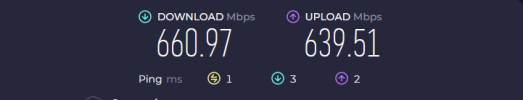

hi guys dont know what to do I been streaming with same pc for 5-6 months something like this on 18k bits or sometimes even less never happened but know when I tryed I noticed big frame drop for the first time can someone help me plz guys here is my obs log with same settings been streaming for so long never happened something like this even tho updated drivers etc and network drivers help! Bonus on twitch or kick platform no issues at all stream quality good but on youtube insta drop frames and huge tryed everysingle encoder

Still same issue there is logo even tho reinstalled obs etc full clear internet like I said tested even on twitch everything is good on youtube still same meybe its just youtube suck on streamining ???? bc like I said never had this issue and I even showed you my internet speed etc its too good
even tho tryed to disable The Hardware-accelerated GPU scheduling this but it was same results nothing changed after this tryed internet optimizer on obs still same idk what to do ....
