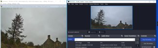

Just an update, had the same problem last night, lost about 2 hours. Image shows the RTSP stream running on OBS v running on Contacam at the same time this morning.
Log file is here…
Can anyone offer any help with this please ?

Frame-rates don't match & how about the record speed not matching? 100 vs 1.29x....
From your OBS log:
13:19:52.100: base resolution: 1280x720
13:19:52.100: output resolution: 1280x720
13:19:52.100: downscale filter: Bicubic
13:19:52.100: fps: 20/1
13:19:52.100: format: NV12
13:19:52.100: YUV mode: Rec. 709/Partial
13:19:52.432: [Media Source 'Aurora Camera']: settings:
13:19:52.432: input: rtsp://user:pass@192.168.1.10:554/stream1
13:19:52.432: input_format:
13:19:52.432: speed: 100
13:19:52.432: is_looping: no
13:19:52.432: is_linear_alpha: no
13:19:52.432: is_hw_decoding: no
13:19:52.432: is_clear_on_media_end: yes
13:19:52.432: restart_on_activate: yes
13:19:52.432: close_when_inactive: yes
13:19:52.432: full_decode: no
13:19:52.432: ffmpeg_options:
13:19:52.436: Switched to scene 'Scene'
From your capture:
Similar issue here. Except I loose 3-4 hours after about 14hrs os streeming. If i reset the camera feed in the Sources box it resets to the current time but i can see right away that it's slower. ALso about 36% frames lost due to rendering lag.
Update.....I reset the steam and the Stats capture. The times is obviously slower on the feed output with no dropped frames at all.

From your capture:
Hi
Thanks for this, sorry for such a slow response, been dealing with a family crisis. Just getting back online now tho and trying to sort this out.
So, I'm a total newb at this ! What do you mean the frame rates don't match ? Looks like the Contacam software is at 20.1 FPS and so is OBS ? The camera I am using can only do 20 FPS so will that be a problem ?
With regard to the record speed, what is this please ? I am not making any recordings of anything just live streaming to YouTube. Is there somewhere I can change the record setting anyway and should I change it to 1.29x instead ?

I muted the audio from the camera and immediate improvement! I will double check in a couple of hours to see if it lasts.
Thanks again.
