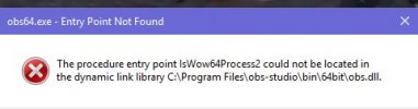

I've been having no problems using Obs for a while. Recently I had a problem with Smplayer and uninstalled and reinstalled it. After that I get this message. Any suggestions on how I can get Obs running right again. I already reinstalled it but no change. Thanks. Wow64.jpg

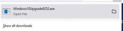

Click the big blue "Update Now" button from the below link to download the Update Assistant for Windows 10. Run the .exe it download and follow the on-screen instructions. This will both update Windows 10 and fix your Update issues.
I clicked the update now but just got an error message
kimlee333
I found a solution.
1. Install any hex editor.
2. Make a copy of (for safety) ....\obs-studio\bin\64bit\obs.dll and name obs_bkp.dll
3. open the file obs.dll in hex-editor.
4. Search for "IsWow64Process2" (search as ASCII, case sensitive)
5. Select the number 2 in IsWow64Process2 and replace it hex 32 with 00
6. Save the obs.dll file
OBS started, but I can't guarantee that everything works.
I have not tested all functions. I only found a solution to get OBS to start.
I am asking the OBS community to look into this issue.

AaronD
I found a solution.
I would guess that there would be no problems at all. Something just changed the name to remove the 2, and OBS hasn't caught up yet. Or the 2 was part of someone's testing environment and accidentally got out. Manually editing it to make it look at the correct thing again, fixed it. You're lucky that that's all it was.
Strings (bits of text like names, labels, human-readable messages, etc.) are stored in programs as a list of character codes, but there needs to be some way to say how long it is, or how many codes there are. Instead of explicitly specifying the length or the end, it simply ends with a NULL character, which has the code 00. The program just continues to read until it finds that. So by changing the '2' at the end to a '\0' (programming syntax for NULL, in C), you effectively just put the cursor there and backspaced. The original NULL is then ignored, but you should leave it there because something else is going to look for the next thing at exactly that many bytes after the start of the file.

Suslik V
"IsWow64Process2" is used for logging the OS type in OBS, so it is not very important right now (for details see related PR):
The original error message can be read as:
...the instructions for procedure "IsWow64Process2" wasn't found inside the "obs.dll", neither inside the kernel dll of the OS...
Here OBS assumes that the "IsWow64Process2" is standard procedure/function and it exist in all systems where OBS is running, so it wasn't included inside the "obs.dll" file. If function is missing from the OS - OBS refuses to start. By historical reasons many systems shipped with the similar "IsWow64Process" procedure/function (without "2") inside the "kernel32.dll", so mentioned bit-hack works.
