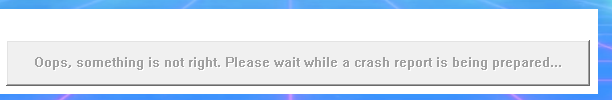

OBS says its crashing when I close it? Not sure if I should be worried about it....
Richy221
Log file: https://obsproject.com/logs/crashes/By28rlRyoTY8zjLI
I have been trying to delete the Atrium plugin lately. Deleting it the dll and pb files from 32 & 64 bit folders seems to not do it as I still see it show up on the plugins manager but it just states that its "missing" with it unchecked. I reinstalled it just for the sake of it and disabled it in the plugin manager. Once i close OBS it says something along the lines of "oops something went wrong and generating crash report."
Thank you for your time!
Try to launch OBS in the safe mode (no plugins loaded) when it asks you to launch "normally" or "safe mode". Usually, without the plugins, OBS closes without the program crash.
