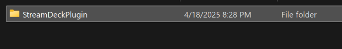

I am having this issue but I am technologically inept. I am not sure what the fix means or what to do. I installed the streamlabs extension, hated it, uninstalled it... it ruined my OBS and I had to install OBS again. Ever since then my stream deck will not let me set an OBS scene and has the "waiting for OBS" error.
Check %PROGRAMDATA%\obs-studio\plugins for the files from the system-wide plugin, be aware the directory structure is a little different. Files in the bin/64bit should be moved to obs-plugins/64-bit and data should be moved to data\obs-plugins\plugin-name.
Thank you I did not know there was another directory for plug-ins. Needed this to find the Elgato Stream deck plugin cause it was causing OBS to crash.
