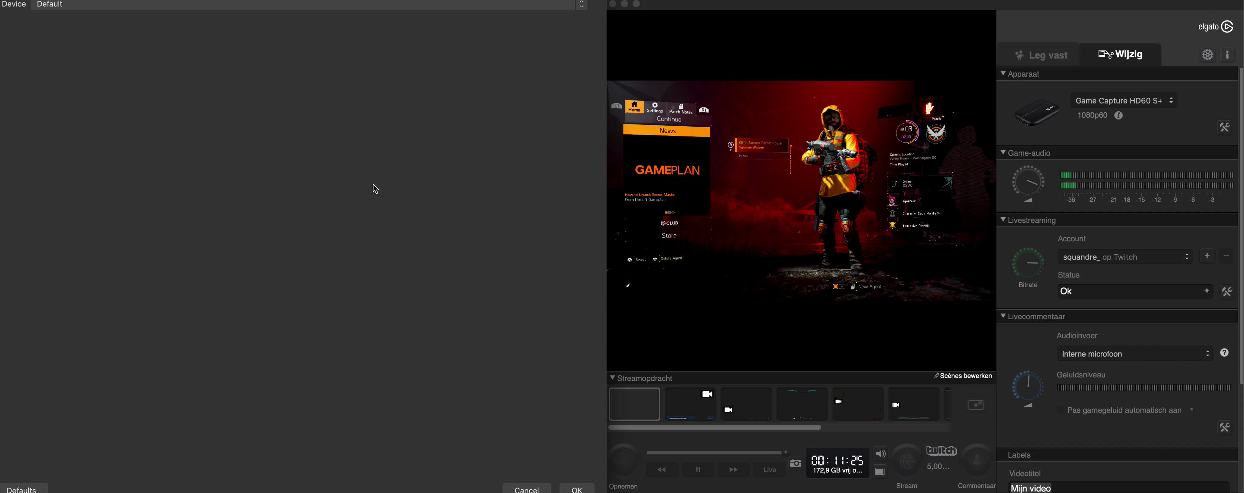

My problem is fairly simple: https://imgur.com/ZSY2haR
I have no audio options in the card settings, which I need to select analog audio.
Any ideas what might cause this?
Sidenote: I'm also unable to select any other resolution than 1920x1080 when I don't select "Use Preset".
> Try to select Use Preset and then change Input format to other
I can't do either. It seems a lot of audio options are just missing.
Made a little screencap video, side by side with Game Capture HD to show what's going on and what's unavailable in the settings.
