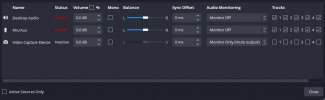

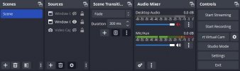

I am trying to record the audio from my desktop and record with my microphone at the same time. I do not have a microphone so I am using the one that is built into the computer. The problem is that the desktop audio also plays quietly through the Mic/Aux on the mixer. I have confirmed it is being picked up by Mic/Aux because I had the audio muted and played a video on my computer with only Mic/Aux unmuted in OBS. My computer volume was also muted so no sound was coming out of my speakers or headphones when I recorded the video, but it still played the audio in the video. I can't hear it all the time, but there are times when it is louder and it can sometimes be heard with the desktop audio and sounds distorted.

I solved the problem by following this video
Ah! Yep! The default processing - in the audio driver, not OBS - to make a conference call work on speakerphone, doesn't know that the mic can't hear the speakers. So it tries to subtract the speakers from the mic...which is the same as adding the inverse, which sounds exactly the same when there's nothing for it to cancel.
It's supposed to figure that out, as part of figuring out what the acoustics are that it also needs to account for, but I guess it doesn't always go far enough to see that it really needs nothing.
At any rate, always look through ALL of the settings, everywhere, understand what they do, and make the unconscious machine work for you, not the other way around. Anything that is not "a straight dumb wire" between the raw source and OBS, needs to go away. If something is there by default and hidden, find it (because you're going through everything anyway) and turn it off.
