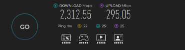

Long story short, my frames have been dropping randomly over the last almost 2 weeks now. I've tried all of the troubleshooting steps listed on here and I fear that it might be coming from a plugin I am using or an application causing the problem. (Note: I have been streaming for over 2 years now without issues and have not had to ever change anything from what I've always had it at and have not recently removed, added, or changed anything to my stream since the frame drops have occured).
I've had my ISP (Xfinity) send a tech out twice, first time they replaced the cabling for my house which did help, I did also replace my ethernet cable (cat6) to my device, and lastly I have the most recent modem/router that they do provide (XB10). I streamed multiple times today while changing everything I can find that was recommended to others on these forums and the different trouble shooting pages provided here and nothing has worked.
I have 2 different logs, both are from today. They are the most recent streams and they are also the ones with the best performances due to what I assume is all the stuff I have changed to optimize the stream. The first is from my old router (XB8) and the second is from the new router (XB10). I'd appreciate it if anyone can help me make sense of the logs.

You're not dropping frames on every stream as there were some clean in the first log. From your second log. Your LAN looks good but I believe the dropped frames are a result of lack of bandwidth, your ISP or something beyond them. Disable the multi-out until you get it figured out.
