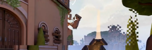

How can i solve this broke image?
Stics
A few days ago I noticed that the image is broke (striped and square) when i make fast moves/flicks. I capture only the game. Does anyone know how to fix it? It's kinda annoying to see those.
Base resolution: 1920x1080
Output resolution: 1920x1080
Downscale filter: Bicubic
FPS: 60 fps
Recording format: mp4
Recording encoder: NVIDIA NVENCH H.264 (new)
Rate control: CQP
CQ Level:20
Keyframe Interval:0
Preset: Quality
Profile: high
(here is the link with a mini video so u can understand what i mean: https://streamable.com/hc4om2)
I attached a screenshot too

I still have this problem...
Here is the log: https://obsproject.com/logs/-SOEf9z0TfqguEcg
#1 from previous post and
Display and Game Capture Sources interfere with each other. Never put them in the same scene (scene: Recording).
It seems that the 3rd party plugin you are using (the "win-capture-audio") has constant memory leakage. That means that the plugin's code written with mistakes.
As for the image that breaks into a square blocks - it is hardware error of the encoder. If PC is stable (no overheat, default settings etc) - try to ask encoder's manufacturer (NVIDIA in your case) they may shed a light on what is going on here.
