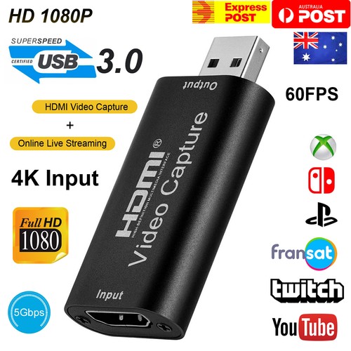

I bought a HDMI to Usb 3.0 dongle (a dirt cheap one..see pic) and a brand new mini HDMI to Standard HDMi cable.

Device is based on Macro Silicon MS2109 chip. (like here: https://www.youtube.com/watch?v=R4SXJMNywL4)
It is USB2.0 device, max output is 30fps at 1920x1080p (MJPEG codec).
Delay about 100..200ms.
The color bars goes from the USB-dongle device when it is busy (no input). So, the USB to OBS part works OK.
At least try other source of the HDMI signal (maybe at lower FPS) or try other cable.

Thanks for the rwply mate. Pretty sure it's usb 3.0
This is a link to the actual item I bought.

Just a sanity-check, have you plugged the Canon's HDMI output into a TV or monitor to make sure it's actually outputting an HDMI signal? I've seen weird stuff like that happen, and since you're getting color bars from the USB device, the USB transport is confirmed-good. Checking that the camera is sending a signal at all is next-up in my book, and easy to overlook.
I've been bitten by that myself in the past.
Also, that's definitely a USB 2.0 device with some 'creative marketing'. Per the 'features' on that listing:
Support output max resolution 1920×1080@30Hz.
That's the USB 2.0 bandwidth limit kicking in right there. It might accept a 4K signal source, but it's going to downscale and output 1080p30 at absolute most, because that's the max a USB 2.0 connection has the bandwidth to support. Even if they put a blue connector on it.

So...... Took ferretbombs advice and checked the camera on my tv. Nothing showed up. So my fear was that the hdmi out on the camera was cactus.
Went to my local elctronics store to buy another lead. They didn't have one so just bought a mini hdmi adapter fo a standard hdmi cable and BOOM!!! It works!!!!
For the life of me I didn't think it would be the cable as it was brand new. Took it out of the package, connected it, and then didn't touch ot again. So I thought there was no way the lead could have been damaged since it was working before.
Also, pretty sneaky marketing for sure. But I guess that's why it is a $17 dongle instead of something like a cam link which is $200!
