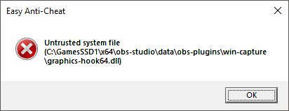

Had the same issue when attempting to stream Division 2. So far the only games that are effected in this way are those protected by Easy Anti-cheat software. In the case of both games, with the OBS anti-cheat hook enabled, the games either freeze or drop to <2 FPS and no game footage is captured.
With the hook off, FPS / performance returns to normal but still no capture. The the case if division2, on game close obs is flagged by Easy as illegal:
Dy1jImJW0AAYHWw.jpg:large
Uninstall OBS from your custom location and install it to the default Windows program files location to the proposed default path: C:\Program Files\obs-studio. If you keep your user settings at uninstall, you lose no settings - just uninstall and reinstall to default location.
You might have to reinstall any installed custom plugins to the default path as well, of course.
OBS itself is agnostic of its install location. But apps installed to c:\program files get additional permissions by Windows.
It also might be that some security software actually looks at the physical install location and distrust everything that is not installed there. The latter is not best practice, but you never know what oddities security software will contain.
