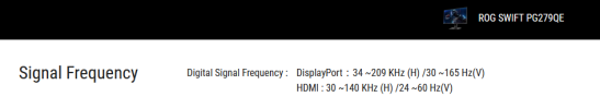

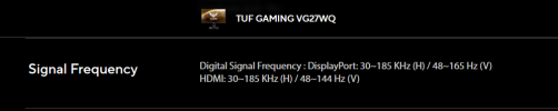

Looking at the specs for your monitors, are both hooked up using DP?
The ROG Swift is limited to 60HZ with HDMI but the TUF isn't, with HDMI max refresh is 144.
