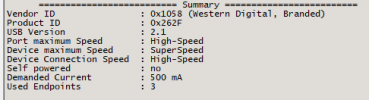

Further analysis with the tool tells me the capture card, although plugged into my USB3.0 port with a blue cable (which should indicate 3.0 correct?), is registering as only a 2.0 device on port 7...
Companion port 23 is supposed to be the 3.0 port. Shouldn't it be showing up there? Would that mean the cable is the problem?

Here's the screenshot you posted, Ports 23 - 26 should be the (4) USB3 ports located on the mobo I/O Panel in the back of your PC.
Everything else (1-22) is more than likely USB2. Verify with the Tree Viewer, click on a Port, look at info provided to the right.
Your capture device is a USB 3 device, if it has a blue jack. If its jack isn't blue, it's not a USB 3 device. The cable also has blue plugs, if it is a USB 3 cable. Try a different cable, may be the existing one is defective.
If you're unable to make your capture device run with USB 3 speed, it's running with USB 2 speed. With this speed, the highest resolution that can be properly transferred is 1920x1080 @ 30 fps. 60 fps is too much. If you're only able to run with USB 2 speed, check the source properties in OBS and select 30 fps to avoid 60 fps, even if your console supports that. Lower resolutions might be possible to run with 60 fps, but that's a thing to experiment.

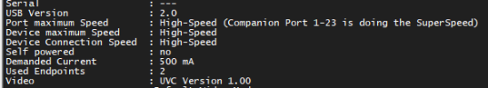

So from what I added here, it looks like the device itself was listed online as faulty advertising as usual. It's only High-Speed maximum capable? Despite being listed as a 4k60fps capable device...

@MrGhost While it's not wrong what you write per se, it's not helping the point of this topic. The OP has an issue he needs to solve (bad console capture). While discussing possible causes, it came up that it runs on newly acquired 2nd hand hardware. In such a case, where "it didn't work even once before", you need to question that hardware, what I did. The comment on the price/performance ratio was just a side remark. The hardware itself, if functioning correctly, is solid and was in broad use at the time, so no issue itself. He wants streaming a console, so no high GPU performance requirement. You don't need to extend that hardware part of the discussion. For OBS processing a capture device gaming console image and a simple scene setup, a GTX 1050 is sufficient.
The real cause of the issue turned out to be the USB capture device. That has nothing to do with the base computer hardware.
In case you want the crucial (and only required) posts in this thread, its:
#1 (description of issue, including logfile)
#2 (indication that it's something with USB bandwidth)
#21 (link to proper USB visualizer)
#36 (proof that it's the real USB speed isn't what was advertised for the device)

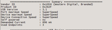

Capture Device is bad no doubt but it looks like it was still connected to a port that was operating @ USB2.0 only.
USB3.1 connected to USB2.1 Port
The same device connected to USB3.1 Port
