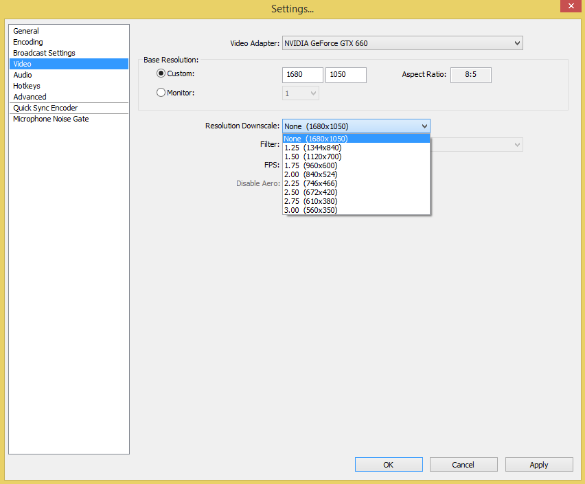

Did a test stream, and the stream is at a good quality, but every 7 seconds or so, the stream loads/lags for about 5 seconds before resuming. I don't see any dropped frames in the stream or the game.
I used the estimator and using all recommended settings. But one thing said I should downscale to 480p or similiar low resolution. How can I do this? I don't see any 480p option here, or am I looking at the wrong place?

If the stream isnt lagging/buffering on other peoples computers, then don't worry about it. It's most likely out of your control anyway.
As for the 480p option. It isn't listed there because your base resolution isnt a 16:9 resolution. Use the equivilent option, which is 2.00 (840x524)
You are using a monitor with 16:10 aspect ratio that's why. I suggest you make your layout 16:9 ratio regardless, otherwise viewers watching on Chromecast will have the top/bottom cut off slightly.
Yeah, its probably a good idea to set your base resolution to something like 1280x720, and then downscale it to 854x480
