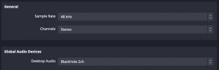

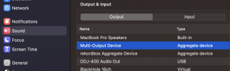

Hello,
I've spent many hours reading posts on the forum and trying to fix my issue but it just doesn't work.
I simply want to record a mix from Rekordbox via OBS (no streaming). I had to install BlackHole since when i was trying to record the audio output, it would also record the external sounds via the microphone.
So I've installed all these software, created a multi output device in MIDI Setup, etc. Also installed both BlackHole 2ch and 16ch since I've read it could help. But nothing works. Now when i try to record the audio in quicktime or via OBS there's no sound at all.
I'm attaching the screenshots of all the setup i have. Hope someone can find where the issue is. Thanks a lot!

You are using DDJ400?

Since nothing is coming through now, double-check that Rekordbox is set to output to the multi-output device. Also, ensure OBS is capturing the correct input source. Sometimes, restarting after setting up BlackHole helps. Have you tried testing with a simple recording app before OBS to isolate the issue? Hope you get it working! I am a college student and sometimes I feel the need to seek help in writing work. If you’re also looking for a trustworthy academic online writing service, I highly recommend Academized, which is available https://academized.com/ here. I used it for my economics paper, and the results were fantastic. The writer followed all my instructions and delivered a well-researched, professionally written paper that impressed my professor.
