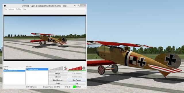

The problem may be my unfamiliarity with OBS. The only way I've been able to record X-Plane in the Game Capture mode is to have OBS open and on top of the window showing X-Plane. Is there another way to do it?
Below is a screen grab showing how I set it up. Of course, before recording, I stop the preview.
Yes, I'm working with one screen. Is there another way I should be doing it? Screen is different from monitor, I assume.
Bill
Hmm, what happens if you switch to Xplane after you started the recording in obs. So obs is in the background. Can you then use xplane normally? OBS should still capture it with gamecapture just fine.
I would recommend to just do a test recording then and check the video afterwards. Make sure you use a video player that can playback mp4 files. VLC media player is normally pretty good.

Jack (and everyone else), I'm pleased to report that your suggestion works like a charm. I open and minimize X-Plane, open OBS, select Game Capture mode, minimize OBS, maximize X-Plane, click the hot key to start recording, and everything works perfectly. The recorded images are crystal clear and very smooth and the sound is great too.
