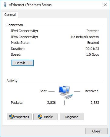

"Your gigabit-capable network card is only connecting at 100mbps. This may indicate a bad network cable or outdated router / switch which could be impacting network performance"
Can you check your network connection properties: Check the SPEED
If it's reading 100mbps, then try the following, click on properties > configure > Advanced > Speed & Duplex
if it's set to 100mbps (which I doubt, more than likely it'll be Auto Negotiation) , set to 1.0 Gbps Full Duplex.
Then go back to the above image and check speed. If it now reads 1.0Gbps, retest your stream.
If it STILL reads 100mpbs, check your ethernet cables are CAT5 or above to enable 1.0Gbps connections >
what if its not cat5 or above?
Then you won't get the full 1Gbps connection
