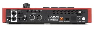

Hi Jonathan - I saw your message earlier... I went out to try and hook up my gear like you suggested, and I found that I already hooked up the mixer to my Akai MPC unit. I believe that I can't in turn run the Akai (which also has the same USB A to B cable) to my laptop's USB port. I actually tried that, and absolutely nothing happened. I saw no different audio input pop up in the OBS software.
As it is, I have the USB audio interface running from my mixer to the MPC (and I'm incredibly happy with the recording ease and quality I'm getting with this), then the MPC goes out to my amp and speakers.
I just can't figure out how to get the audio from my MPC into the OBS audio input.

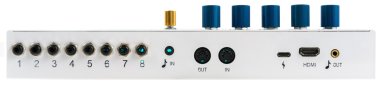

I'm attaching some shots of the ins/outs of my gear. I'm really confused and frustrated to being so close to having all my gear communicating together and synced to BPMs, and near-perfect audio recordings, to come right to the edge of having my audio/video combined.
I will appreciate it forever if you or someone else reading this can help me figure it out.
(The white unit in the photos here is the back of the piece of gear that is providing my live video show - my live music audio is run
from the mixer in to the MPC with the cable you mentioned previously.)
I hope this makes sense.
First of all, I'm amazed at how the mixer and the akai are connected, I had no idea that you could connect audio equipment to each other with a usb cable.
So I could find (and understand) if it would be possible to use the One+ as an interface, but it is necessary to install the MPC software and download a plugin and I don't know what else... I didn't understand much, and I'm not sure it works with OBS either.
In my opinion, one of the best options is to get an audio interface and connect it between the AKAI and the amplifier. From my perspective, that is the simplest and safest option.
