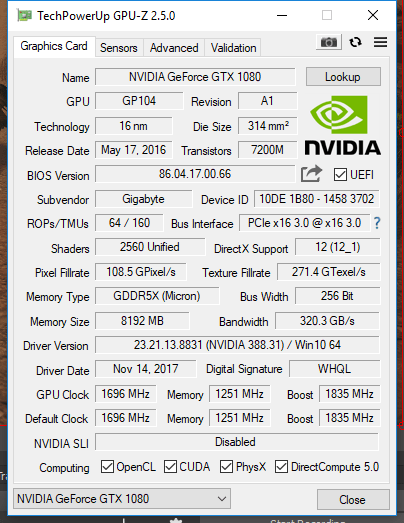

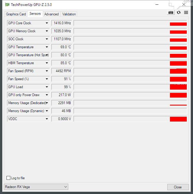

Ok, everything looks good there. Can you get one of the sensors tab now as well? Do one with OBS open, but idle, and then get a second shot with OBS actively recording.
Theres got to be some kind of bottleneck here.
Fenrir
Forum Admin
Hm. So not a GPU bottleneck.
