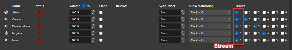

In order to set up our tracks, we need to access the "advanced audio properties".
Here we can assign which sources we want to go on which track.
In this example, I'm going to leave all my source enabled on "Track 1", because that is the default for the stream, and I want it to contain all sources.
Then I'm going to spend my remaining tracks 2-4 to have full control over the each source in post (editing).
  • Track 2, only "comms" (discord, skype etc) is selected, so that I can add/remove, mute it later.
  • Track 3, only has "desktop-game", because I might choose to change the volume, or change the speed.
  • Track 4, only has "mic/aux" so that I can potentially change volume, or add effects/noise removal.
I chose to leave the music out in my setup, as I have full freedom to add/change that later.
