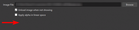

how about a small info text that this is a async source at this position ?
edit: oh ya the source toolbar is a hint for that, thx
As long as I stick to the original options I can use its translations into 61 additional languages, any additional text will immediately look out of place for anything outside of English, because I am always lacking the 61 translations for it. That's also why in the main menu the item is not translated and will always say "Image (Async)" even when your Italian OBS would label the original source as "Immagine". I thought about just putting "(Async)" next to the original text, but then again not all languages would have such addition to the right side of the text, by grammar logic or because it's a right to left written language.
But the one thing I will do here is just put the text "(Async)" at the top of its options on a single line for all languages, then I also don't have to worry about having it right or left of something, so thanks for that idea.

I asked about this specific section in the main window that displays a file path for the original image source and how I could show something there on the dev Discord channel, and the answer was:
So I guess this difference will stay and help to distinguish it from the original.
