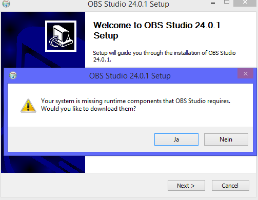

So I have a new desktop and wanted to install OBS. So I go to the site and download it for Windows as per usual.
Next up while starting the Setup it tells me that I need to install other components.
It redirects me to the download link which lets me download and set up Visual C++. After it is finished I restart Windows and click on the OBS setup only to receive the same message, that I need to install components, yet it redirects me to the exact same download link.

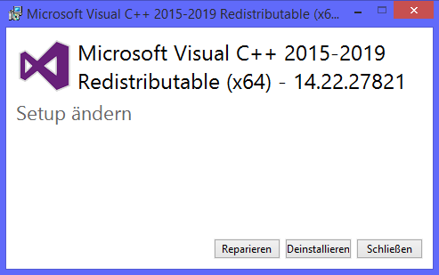

When I try to install Visual C++ again it shows me this. I have the option to repair or uninstall. I even tried repair and restart but it did nothing.

If it is of any help: Everytime I install C++ it gets stuck half way. I then cancel it and retry the Setup which then suddenly works very quickly. Seemed a bit suspicious but I never got any error message. Just adding this here as it might be useful information.

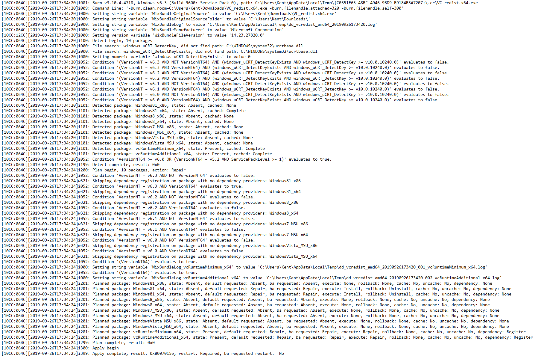

If OBS still shows that message, the installation did not succeed. The installation after cancellation that "suddenly works very quickly" is not working.

Regarding the log's, I can not acces the folder as I never had OBS installed. I can however give you the only log file of C++ that I could get: https://s17.directupload.net/images/190926/ucgr4l6k.png
