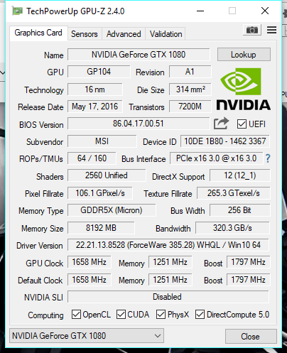

My specs are:
5820k 4,4GHz
GTX 1080 2,1GHz
16GB RAM
THe problem shouldn't be my specs, but who knows.
