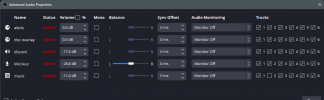

So this is a bit irritating… I received a copyright for the fact that the vod track wasn’t working, I never change any of my obs settings yet sometimes the vod track works (no music in vod) & other times it doesn’t (music in vod). Anyone know how to fix this issue?
Edit: To clarify if I click the box to turn music on for vods then click it again to turn it back off it’ll work again & there will be no music in my vods but then like 3 streams later there’s magically music in my vods again even tho I changed 0 settings.

same to me! when I start my stream, VOD track 2 turns on automatically and i receive a copyright warning, and it's a bit frustrating bec i can't take clips or share on socials for copyright, no solutions from long time , today i tryed to switch on channel 3 and it seems it works at the moment, it only appens when you wants to start the stream
